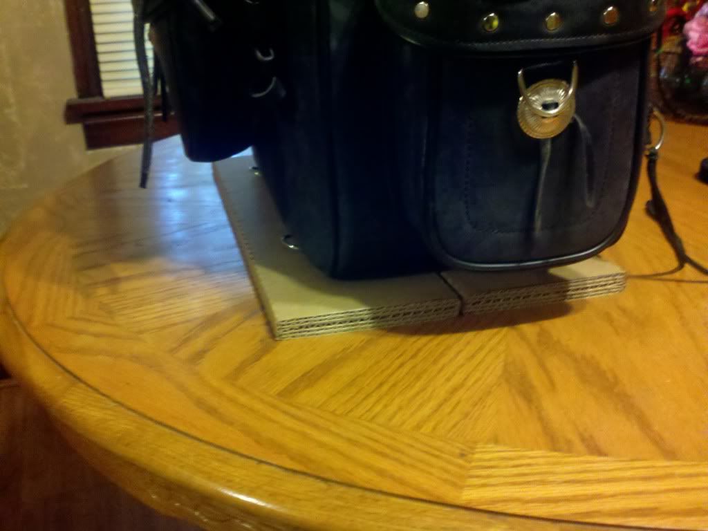

My luggage Rack Bags were drooping over the end of the luggage rack pretty bad. When things got settled after riding awhile, and add the heat, it got even worse.
Now, I will give credit where credit is due. Epiphysis got a cutting board, and trimmed it to his luggage rack when I saw him in Indiana. That got me thinking.
So, we ordered a 6 ft. sub from subway at work today. Under the sub is a 5 layer thick strip of cardboard. Very sturdy. I took it home, and cut it a little over the width of the luggage rack bag.
Wasn't wide enough in one strip, so what is a guy to do? DUCT TAPE!!
But no! Wait! Not a little Duct Tape! Lets make that thing Waterproof! (it is cardboard, after all!)
Got some velcro, strapped it to the luggage rack.
Bingo! One non-droopy bag!
You know, I would think of this AFTER I buy a Tour Pak, right? :D
***Side note: This DOES restrict the opening of Hard Mounted Saddlebags. I can open mine about 45 degrees... enough to get in it, but if I have to pull out the tool bag or something big, its got to come off. Thinking ahead (I wasn't) I would have cut the corners to allow full access to the saddlebags.
All materials:
Sandwich board from Subway... I'm sure you could talk them out of one for a couple-few bucks... Call it $5
Duct Tape... Free. (Every man has Duct Tape for cryin' out loud!) Ok... $5
Velcro Straps... $8
Total Mod Cost: < $20
-Gonz

When that cardboard breaks down you can get a old ceiling fan blade and put inside the cardboard to make it more firm. Just my .02. But way to use the noodle. Keep on creating you might just find your million dollaer idea soon.

Good idea on the fan blade! But 5 layers thick, and after the duct tape, I can put that thing on a stair and stand on it. If I sealed it good enough from water, it should be fine for awhile.. But good idea on the fan blade!

Another idea .. Cut it just a hair bigger than the inside of the bag and force it into the bottom of the bag. It should be sturdy enough from the inside. Waterproof, and won't be in the way of the saddlebags.
This is how they do Chinese food delivery in the city.. cut cardboard to fit the inside of the bags to keep everything level and sturdy. :)
