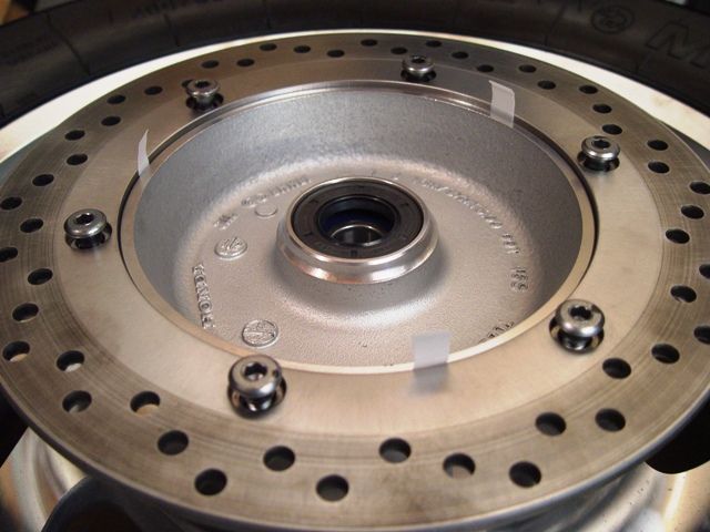

I'm one of those guys who successfully re-used the wheel's rotor mounting bolts, without any problem at all. In the pic below are three 0.010” Teflon (compressible) shims that I used to maintain concentricity between the rotor and the collar feature of the wheel, while tightening the rotor mounting bolts. I removed the shims after torquing all rotor bolts (using a ‘star pattern’, with gradually increasing torque) to the Service Manual spec (I used red thread locker on the bolt threads). The rotor in this pic has a larger diameter center hole than a stock 1300 rotor (in order to fit an 1800C's wheel), but you get the idea. When re-installing the wheel on the bike, don't forget to put Moly60 paste (now Moly77, I think) on the 'male' driven-splines of the wheel and on the 'female' splines of the final drive (that is all detailed in the Honda Service Manual). Here's the pic:
