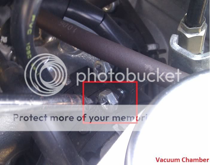

This is the screw that needs to be loosened to pull the carb off the manifold before doing jet work.
241472

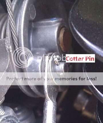

To get the bowl off the bottom of the carb this cotter pin needs to be removed.
Also remove the screws on bottom. :)
241473

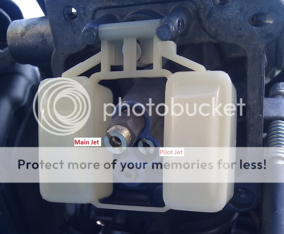

This is the bottom of carb with bowl removed, showing jet locations.
241474

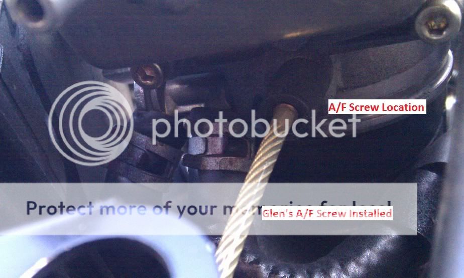

A/F screw location.
Behind the two rear screws at bottom of bowl.
This is after installing the long Glen's A/F knob.

I did not take picture of the vacuum chamber parts I think that is covered pretty well in the scar write up.

Is it possible to replace the a/f adjustment screw with the Glen's permanent one without removing the tank/air filter/carb. ? Is there anyway of adjusting it without taking it all apart?

You have to take the tank/air box off to install Glen's AF needle. After it is installed, you can adjust the AF just by bending over and turning the knob. If you don't have Glen's permanent needle, you have to use a long, blind adjustment tool. In my experience, virtually impossible to do.
114 Posts
Pretty much: No unless you have already replaced the airbox with something else that can be removed without taking off the tank. It is best to have everything off anyways so that you make sure you get all of the little parts out of there. (Trust me I know... I had a o-ring break up and thought I had it out completely on another bike but since I didn't take the carb completely out, I never saw the minuscule piece stuck up in there until I pulled the carbs and cleaned them several times then checked it and found it. It was a bitch to get out)

I have tank off now (coolant leak fixed) so might take pictures of the vacuum chamber.
