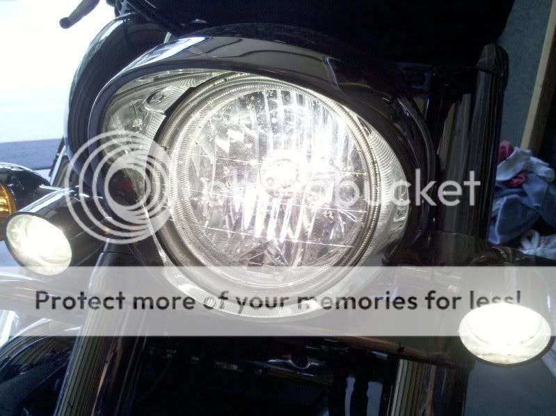

The high-beam finally went out on my Silverstar H4ST after about 3-3.5 years. I have always liked and used PIAA products in my bikes/trucks in the past, so I figured I'd give one of their bulbs a try this go around. Yes, they are almost twice the price as the Silverstar, and much more than the Harbor Freight bulbs that people have started using around here.
While I changed my bulb, I figured I'd snap a couple pictures. Not sure what this tells anyone, although the PIAA did seem brighter in my garage. I get off of work at 0200, so I could use all the help I could get. I will see how this does tonight on my way home from work. They are both rated at 4000k on the Kelvin color scale and I couldn't find complete lumen specs to compare the two.
The PIAA I purchased is the Xtreme White Plus Anti-Vibration Powersports bulb. Part number from PIAA is 70456.
Here is a link to this bulb on Amazon: http://www.amazon.com/PIAA-70456-Xtreme-White-Anti-vibration/dp/B000TK3U4O/ref=sr_1_2?ie=UTF8&s=automotive&qid=1276547333&sr=8-2
Anyways, here are a few pictures...
The Silverstar still in the bike (low-beam):

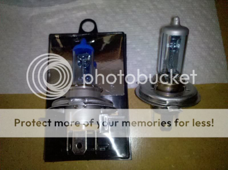

The PIAA bulb on the left and Silverstar H4ST on the right:

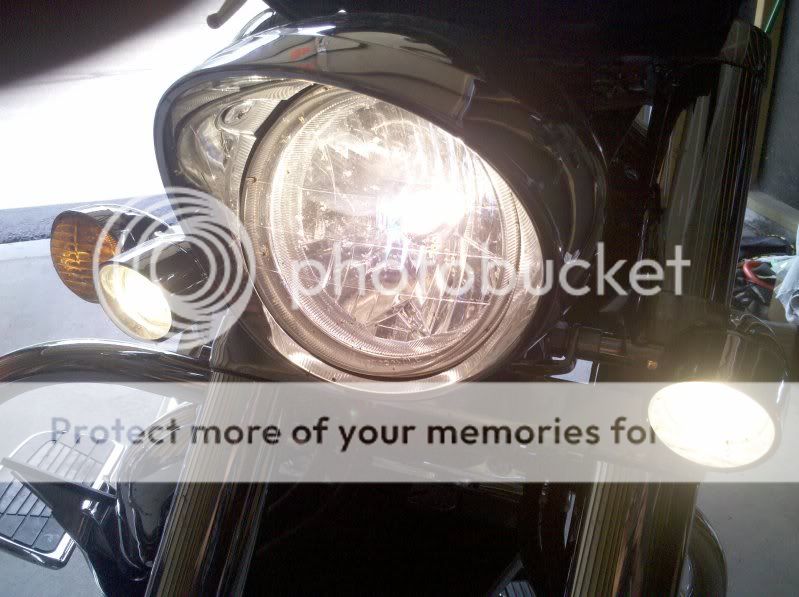

The PIAA bulb installed (low-beam):
Finally, a side-by-side (H4ST on the left - PIAA on the right):
As you can see in the picture with the bulbs next to each other, the PIAA has a blue cap on the end. This does add a slight blue tint to the light (I mean slight....I will be able to tell how "blue" it is on my way home from work). Just from seeing it in person and looking at the pictures, I'm somewhat surprised they have the same Kelvin color rating.
Anyways, there's my non-comprehensive picture comparison. :D
I will see how long this bulb lasts. I figured it was worth a try since I really liked PIAA products in the past, but only time and night riding will tell if it was worth it or not. Either way, to me, there was only one way to find out. :patriot: :choppersm

Alright, my cold test ride home is done. :D
I will say right away that this is a brighter bulb than the Silverstar. How much brighter? Well, I don't think anyone could really say without some sort of measurement tools. Even then, the measurements can be off from real life experience. One of the biggest improvements that I noticed was more of the side of the road being lit up. The light is also projected slightly further down the road and it's noticeable at the higher speeds. Having a good size fox run right in front of me was a good reminder of why I have the brighter bulb and driving lights installed. This is a regular occurrence on my rides home. In a place where Elk, deer, foxes and coyotes are abundant, the brighter and additional lights are a safety addition and something I wouldn't consider optional.
Is it worth the difference in price? It honestly wouldn't be fair for me to answer this question either. Is it worth the difference for me? I can't really say that yet either, especially since I've had this bulb installed for less than 24 hours. Lifespan is a factor in whether there is value in the difference in price. If someone were to only buy/have one or the other, then there's no difference for them to notice!
Either way, as I said above, I have always been very pleased with PIAA products and I'm not expecting anything different here.
Do I regret my purchase? Absolutely not. There is a noticeable difference in brightness over the Silverstar and I'll take what I can get (while staying with a regular bulb).
I hope this helps for those of you who were looking for more information. Ask away if there are any other questions and I'll answer them as best as I can. :cheers:
