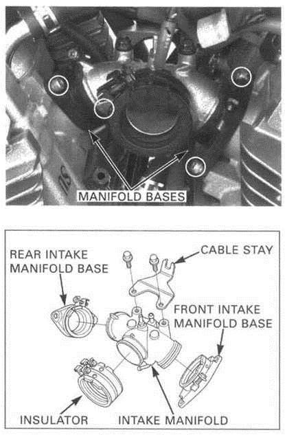

Besides answering the questions and complete backstory requested above , please consider this for example: if any of the four bandclamps that attach the intake manifold to the cylinder heads and to the carb are loose and leaking air, then you could experience the exact same symptoms that you describe - your resolution might be as simple as tightening 4 clamps - "I'm just sayin'...":
Exactly... Sure would save an engine removal & head removal to check valves...
