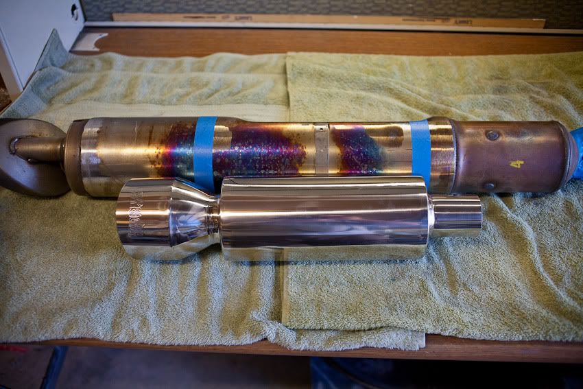

The pipe itself has been modified, all of the Honda baffle system has been removed and a race pipe has been installed in place. Here is the write up I did for the original set of 2-into-1 for the 1800C: http://www.vtxcafe.com/showthread.php/78646-Stock-Exhaust-mod-VTX1800C-Pipes-2-into-1-Honda!
I am including photos for Sunday's install for clarity, this was a little different than the first one I did but it actually took a lot less time this go-around. First time I had the baffle system blown out with a torch and then ground out the rest of the material, this took forever....this time I just drilled out Honda's spot weld locations and the baffle came right out (with a hammer).

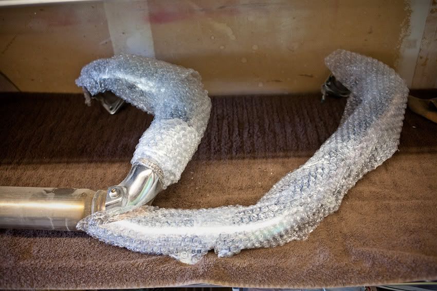

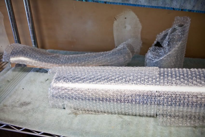

Bubble wrap all of your parts so you don't scratch the chrome.

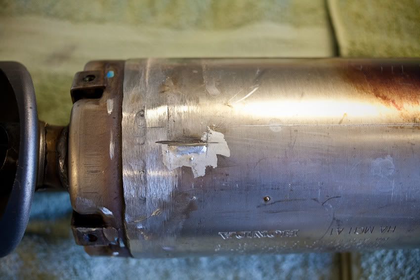

Mark the rear pipe with your knife before you remove the chrome panel with the grinder wheel.
Get your new pipe ready. 3A-Racing 63-0544 (4.25" outer diameter)

Notice I drilled out the welds, this saved huge amounts of time. The front part of the pipe killed my drill bit so I cut into it to remove the last 4 welds. There are 6 on the pipe and 4 on the front holding the baffle system in.
