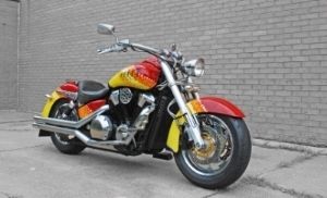

Am wiring an audio system (cycle sounds series 2) to my 06 1800N. I opened the headlight and noticed there is a 3 prong female connector not being used. I assume this for a light bar. It's to the right in the picture.
Can I wire the power and ground wires to this connector? If so, which is power and which is ground. The picture below is of the wiring for the audio system. If I take off the O ring connector on the ground wire, can I plug these wires into the receptacles on the harness. Again, if so, which is power and which is ground?
Thanks for the help.
