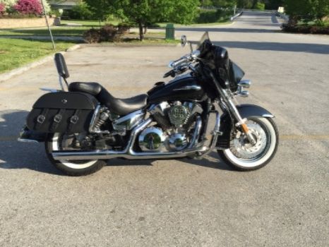

Instead of buy a lightbar, I went ahead and made my own light pod mounting base out of aluminum. Kinda looks like a foot, bolts in conjunction with the headlight mount and exits in front of the fork(s). Anyway, my question is that I searched for some kind of handlebar mounted switch (I'll run via a relay to power the lights) and haven't come up with anything other than ones for 7/8" handlebars. Anyone has a suggestion where to look to find 'em?

Y'know.. Ive had my bike for 2 years.. it has the OEM Hondaline Light Bar..and I have NEVER used the factory switch.
They are just wired into the low-beam circuit of the headlight... and go out when on High Beam (that's the law here in NC).
Rather than a switch... why not just install a relay to the low-beam circuit?

I mainly plan on using them for night riding (55 watt x 2) and want the option to turn on/off when needed. I'm from New Mexico and would like to see what's ahead of me at night..lots of critters around here. I may just make a aluminum mounting system and mount it by the ignition switch (keyed hot), but would much rather have something mounted on the bars I can activate with my thumb.

Here is where/How Honda put the original- basically a small bracket attached to the clutch lever mount..

I bought a Kuryakyn push on-push again for off switch mounted next to my left grip. Sturdy, not that expensive. One thing it doesn't have though is a lighted indicator. I sometimes forget to turn them off, but when I dismount the bike, I sure see them soon enough!

Thanks for the compliment Baker! It's an easy design and I had some plate laying around...cost less than $3 for the two longer headlight bracket bolts. I couldn't see spending $$ on something I can make.
I'll look into the Kuryakyn push on-push switch, but I remember see on the forum that inserted a small switch into the right handlebar switch housing that I really liked.
